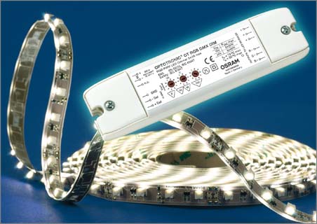

Tagit från ett mail jag fick från Osram
OSRAM presents their first 3-channel DMX dimmer
LED driver | July 20, 2007
With its Optotronic OT RGB DMX dimmer, OSRAM has now entered the world of DMX 3-channel dimmers for LED systems. Since DMX supports up to 512 individually addressable channels, the new dimmer lends itself particularly well to creating effect-oriented lighting in discotheques, theatres or concert halls, as well as to the large-area illumination of architecture.
